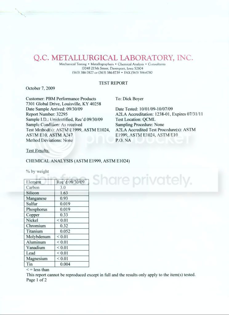

Some more info from Dick Boyer at PBM
Some more info. on the PBM block by Dick Boyer from PBM
Not very impressive numbers
Turbo cam that did the testing did not feel cabon was a major player with cast iron as you could throw a LOG in when its being casted and it would be high any how.
I will compare with your specs to the Little-M only
Silicon Dart 1.270 PBM 1.630
manganese Dart 0.663 PBM 0.930
Copper Dart 0.404 PBM 0.320
Nickel Dart 0.149 PBM <0.01 which mean less then
chromium Dart 0.194 PBM 0.320
Titainium Dart 0.0058 PBM 0.052
Molybdenum Dart 0.211 PBM <0.010 which means less then
Aluminum Dart<0.003 PBM <0.010 which means less then
Vanadium Dart 0.0059 PBM <0.010 which means less then
Lead Dart <0.01 PBM <0.010 which means less then
Magnesium Dart <0.002 PBM <0.010 which means less then
Tin Dart 0.0058 PBM 0.004
Iron Dart 93.2 PBM Not mentioned
I have no record of Sulfur or Phosphorus
With no Nickel and no Molybdenium and low in copper I can't see how it would Brinell test very good but I am not a metal guy either.
I am sure there will be someone that can shed some light on these numbers.

This is the report from an independent lab on th iron in the PBM block and yes it has very little Nickel in it MY MISTAKE ME Dick Boyer made the mistake in advertising that I should have had it tested first. however you will see it does have a good brinel test and contains copper,chromium and lots of Manganese. you will also note that it states whatever the lab said NOT WHAT EVER I WANTED TO PRINT this is a document from the Lab. NO SECRETS! THE TRUTH! The dyno test on the engine I built was performed by a PBM customer that does not want to be involved in this. All we want here at PBM is to give our customers a good product that performs up to there expectations.
